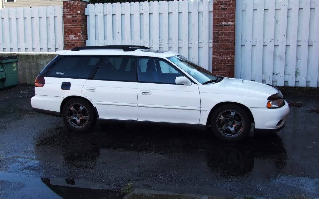

Ok, flame suit is on already for this thread. First off, I am NOT going to cut my springs, even though that is the cheapest way to lower things. This is my dd, so performance is not top priority, although, spirited drives to occur on occasion.
Two main questions here:
1) Anyone ever used the ebay springs here - http://www.ebay.com/itm/00-01-02-03-Sub ... 2314735098
2) Will any impreza parts swap over to the BHs like the older models will?
Thanks in advance!

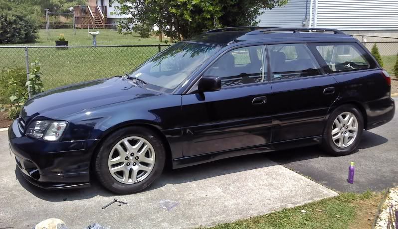

The ebay springs will ruin your struts within a month. Then your point of going cheap was just pointless because then you will need all new suspension. Either leave it stock, or get a good coilover or spring /strut setup.
And yes I have had them. Not on a subaru but on a mk2 VW. The only reason they can lower so far is because the spring is way too small for the strut. So basically your strut is compressed all the time and if you hit a bump you get open space between the top of the spring and strut, so you basically bounce all the time.
I would only recommend them for a cheap beater that you plan on driving a few months till it falls apart. Otherwise dumb idea. I honestly cant even imagine how bad they would be on a heavier car like a legacy as compared to my mk2.
Car in question

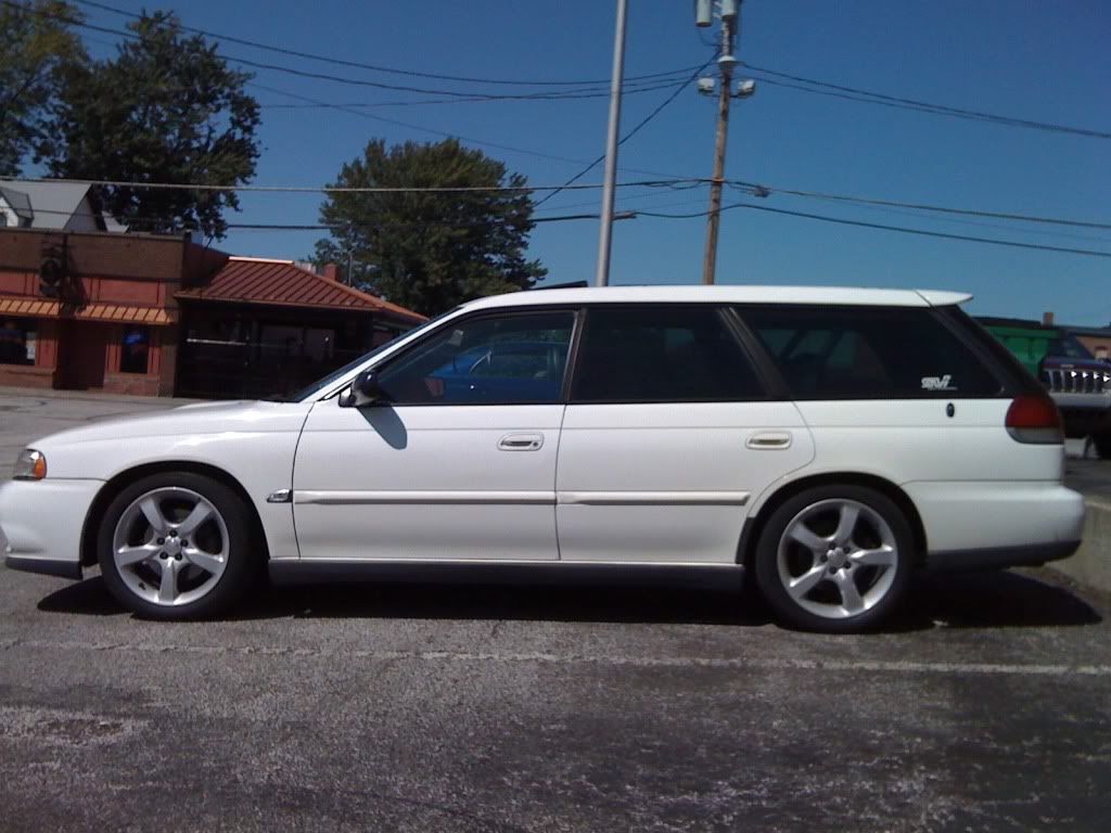

A 1" drop on any properly manufactured spring is rare - on my King Springs Low they quote a 35-40mm drop. That's a 1.3" - 1.5" drop. It's significant and you will definitely notice the difference in wheel gap disappearing, and in overall ride height.
Before:
After:
Now:
They have settled slightly.

Like this for example. Here is my 91 MR2 with just bilstein struts and 16" wheels back in the day.
And here is how the car sits now with 17/18" wheels and the eibach sportline springs. I love the drop and the ride. I have no reason for for more drop, or performance out of a car that is not tracked other than autox from time to time
Here is my subaru in question:
As we all know, with the addition low-pro tires comes the "need" for a suspension drop. A 1" drop would not be worth my money here in my opinion. That drop on the older gen wagon above, would not fill my need for less wheel gap. The newer legacies do have a much more attractive setup from the factory now.
Now, I am biased as this is my inspiration....
And yes, I am aware that will require coilovers for sure.
A real question I have here, is how much harder and bouncier will el cheapo springs be compared to coilovers that are set that low?

^ 18's
^17's (Current)
16's (with the Outback moster truck wheels on)
I'm running H&R Springs, and KYB Gr2 Struts. Spent 500$ installed them myself. Very easy to install, amazing ride quality.
The front suspension works with impreza's and the rear works with BL and BP Legacys.
Dont go cheap. Save your money. Coilovers for the BH's and BE's are expensive. There arent cheap coilovers for our generation. Sorry

MRLancaster wrote:
(with the Outback wheels on)
That looks very acceptable really. Very streetable from the looks of it. I am currently searching for pictures and parts right now, and you just saved me a lot of time with those pics. Seeing the setup with the outback wheels and with the rotas is also a huge help here.
