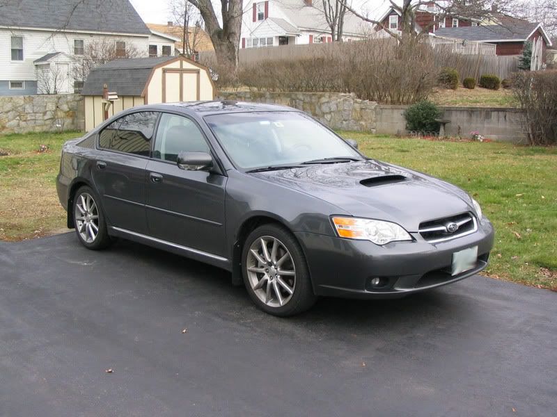

Hey guys and gals, just looking to keep a running online record of my B-ride and the ongoing efforts to make it more and more unique...
Pretty much stock with 35% tint
debadged
OEM vs Function 7 pitch rod
Function7 aluminum dogbone with graphite urethane bushings...makes the firewall act like a speaker!!!
More pics to follow....but here is the comprehensive mod list to date:
