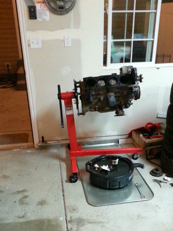

    Block got a lick of silver paint (so you know where it's leaking from. I've never built an engine. It's gonna leak.) after being cleaned with a LOT of degreaser and carb cleaner:
